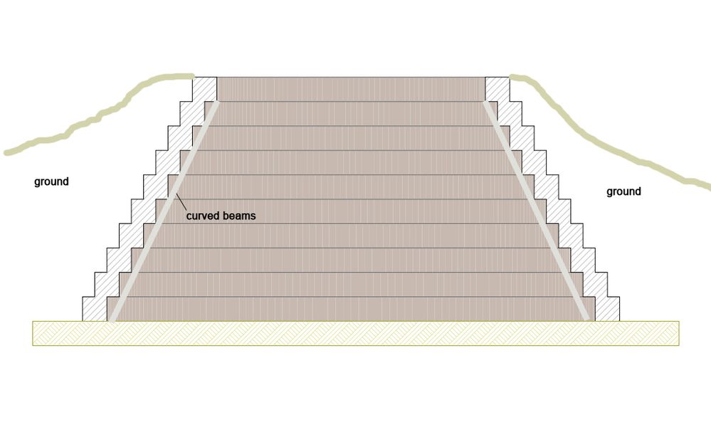

So the question I guess is: how to do it?
You should model the ground using a Mesh. Then use Solid Element Operations to subtract the volume of the building from the Mesh so it will be correctly displayed in 3D.

Nicola wrote:Nicola:
I also want to create curved beams an colums to support my walls inside my green hill.
You should be able to create a custom profile of the curved column (as seen in elevation), then use this Custom Profile (see Profile Manager) with a short length of Wall for each column. Short regular walls can be curved (in plan) for the curved beams.
