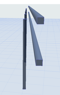

handle anchors do not appear in 3d

how to display the handrails connecting to the inner post railing in 3d

I am assuming that you have fixings turn on in the rail settings.
If that is the case, then check your Model View option settings.
You probably have the railing 3D view set to 'Simplified'.
Need to be 'Full' to show the fixings.
