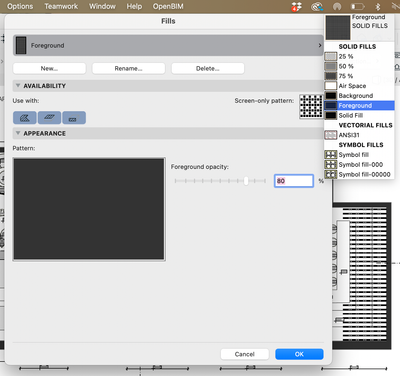

ive created a 3d building and want to add hatches to the plans and sections - except when I press cover fills only transparency options come up eg 25% 50% 75% background foreground. then also when I go view, onscreen view options, there is no option to press vectorial hatches
pls help!!

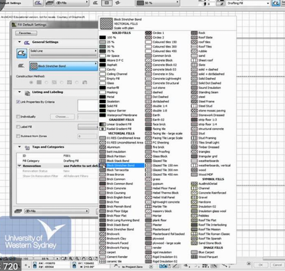

‎2022-08-30 09:27 AM
this is what i currently have as a cover fill option.
this is what i want to have, so that I can add hatches to my 3d objects in plans and sections.

‎2022-08-30 09:36 AM
Have a look at your fill settings and see if all the fills you want have got the 'Cover Fill' option set.

‎2022-08-30 09:40 AM
this is what mine looks like 😞

‎2022-08-30 09:45 AM
Yes, that is good for the 'Foreground' fill.
That is why you can see it in the cover fill options.
Check the settings of all the other fills that you can't see as cover fills - i.e. the 'Asphalt' fill that doesn't show in the cover fill list.

‎2022-08-30 09:59 AM
Is there something wrong with your setup?
I don't have a Mac so can't compare.
But shouldn't there be those coloured dots in the fill settings window?
You should be able to see ALL fill there.
Is your Archicad version up to date with the latest build?
You didn't say what version you are using.
Also is that version compatible with you Mac OS version.
Old Archicad version may not work with new Mac OS and New Archicad version may not work with old Mac OS.
What Archicad are you using and what Mac OS?
