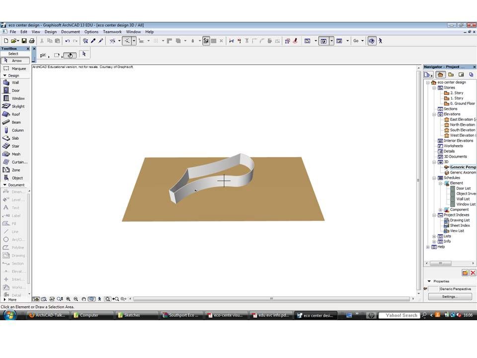

help! Roof on freeform shape
looking to put a roof on this, not sure how or where to start, originally wanted to have a sort of corrugated metal roof.... any ideas?

Dwight
1: Flat roof!
2: leave roof open - pretend is nudist colony fence
3: Use magic wand with auto-polyroof tool for slopes that follow the wall edges - will be wacky just like your plan. See attachment for the tool button.
4: extend walls to twice height, make single slope roof as you like and "trim to roof" for the walls.

which is the magic wand and also auto-polyroof?
below is exaclty what im looking for!

Arched complex profile wall and SEO to extended walls gives you some outside shelter.
Dwight Atkinson
Dwight
arched complex profile wall trimmed with SEO to slab outline
Dwight Atkinson
Dwight
trimmed perpendicular - no new command necessary since SEO's stay live when the arch is rotated.

that last one looks good, now you have me thinking!
i have done the first type with a smaller incline angle of 20 which i quite like, nut i like the idea of the last thing you just showed, what is the process to achieve that??

how do i, Arched complex profile wall and SEO?
i understand the complex profile part and have just tried doing that, but how do i draw a curve that will be accepted as a complex profile?
