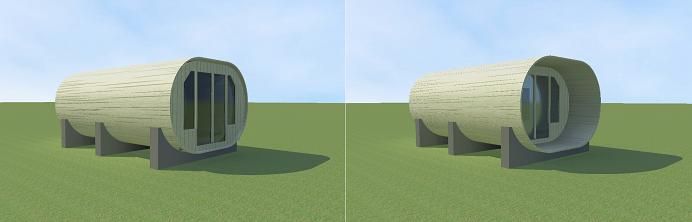

rounded rectangle pipe shape
HI ALL,
I am making a project of sauna in a special shape.. I created inner walls with mesh tool, and the envelope with wall tool, then exported every single part as an object, and used ArchiRotate add-on to rotate them.. Now i can't edit anything It would be also nice to have possibility to add doors/windows from the library..You can't do this to an object
Is there a better way to create shapes like these?

Depending on what version of Archicad you are using (add to the signature of your user profile please) you will want to look into Complex Profiles.
These can be walls, beams or columns - meaning you can add doors and windows to a complex profile wall.
There are plenty of posts here now you know what to search for.
Also in the Help files.
