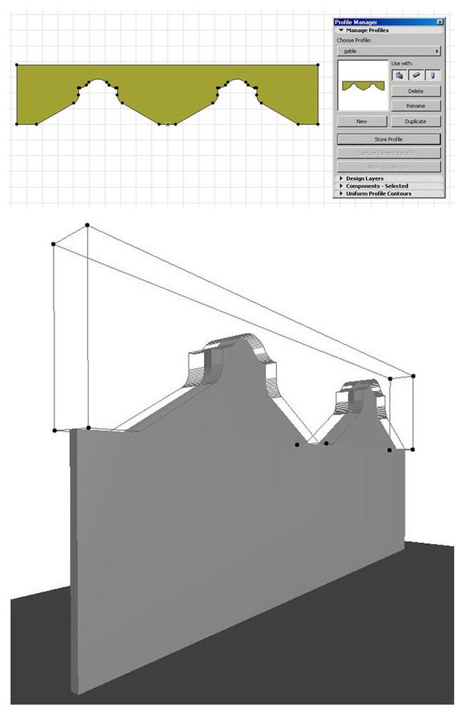

how to draw this wall?
might be a stupid question, but i do not know how to draw this wall with the roof shape and the windows in order to get a 3d model?
For the top of the wall, use SEO (Solid Element Operation) - can be found in the <Design> menu.
Operation: subtraction. Target: your wall. Operator: an element (wall or beam) which has a custom profile assigned to its structure.
In the end, you place the operator on a hidden layer.
For the windows, please see page 322 in AC12 Reference Guide (Saving Custom Shape Doors and Windows) or do a search in AC's Help.

The dutch gable wall can be made by making the gable shape
using TrussMaker and using it to SEO with upwards extrusion
a normal wall as target. If the TrussMaker shape is the shape
of the parapet cap it can be left visible as the cap. There is a
library part that makes quoins that can be used for the normal
quoins but the arched quoins will have to be made using complex
profiles or slabs converted to a library part or possibly making them
using TrussMaker.

Peter wrote:
The dutch gable wall can be made by making the gable shape using TrussMaker
Hi Peter,
Thank you for the truss tip; I've never thought of using it for this type of elements.
After playing a little with Truss Maker in AC12, I've run into a little bug - for this particular example, the result is shown in the screen shot attached. In AC11 everything seems fine.
Can you (or someone else) please confirm if this is an AC12 bug?
Thank you in advance,
Adrian Tudoreanu

truss worked fine for me (AC12 Full, latest build).. it was made from 2 polly lines joined in the center..
some of your 2D line work might not have been jointed perfectly??

ill give it a go with lines and archs. BRB
Yep I get the error with lines and archs BUT… this is what is happening for me
if you draw 1/2 of teh line work then mirror it over to make it symmetrical, then any archs or circles mirrored will cause the error.. if you mirror just the lines and copy the circles over and trim them up (no mirroring of archs or circle) then it works fine
so basicly make the 2d linework without mirroring any circle or archs
