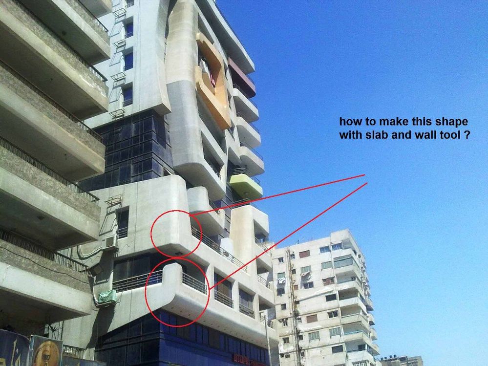

how to make this shape on elevation
Hi there i wonder how i can do this edgy curve between slab and wall as in the image of facade of residential building?
Thanks

Both walls AND slabs can radius their chamfer/bevels.
Simply draw the slab as you want it, using the Pet palette to add radii to the corners.
There's a wall tool - see attached for the special shape-creating tool aspect.
Dwight Atkinson
Dwight
Also, magic-wanding the wall tool to the detailed slab ALSo creates the required form.
Dwight Atkinson
Thanks Dwight for the help i should think in this way from the first
