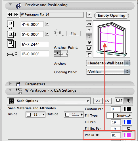

For the window mullions' pen, look under Sash Options > Pen in 3D.
For the other pens, look at the objects' parameters, there will be a few to look through.

Works here. Be sure that Floor Plan & Section > Symbol & Outline > Enable Object's Pens is checked.
