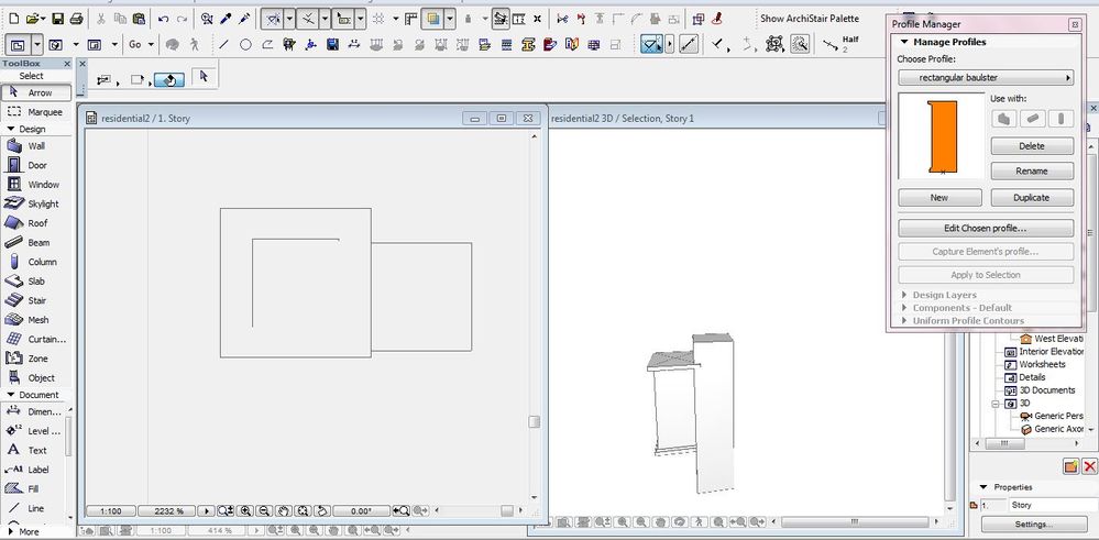

is there multi view plan/3d show simultaneously?
Hi , most of us know the importance of multiview in other words showing plan and section (or plan and 3d) simultaneously , i recognized this is available on MEP but is this also for normal modelling with update automatically every change (i mean i do not have to click on the other view to update itself).
2 REPLIES 2
i mean like this i want to make on 2d and 3d is updating itself while i am working, this feature is very very important how i can make 3d update itself automatically ? without i have to click on 3d window or rebuild ?
This is not how ArchiCAD is designed to work. You will have to activate the 3D Window for it to update.
On the other hand, if you make a change in 3D, the Floor Plan will update.
