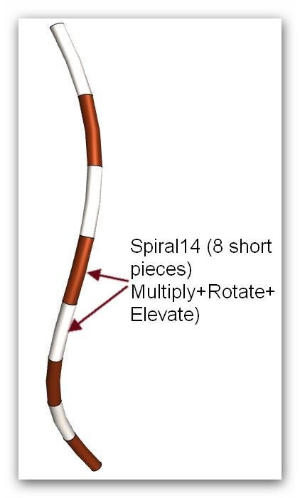

In this example I use object Spiral14 + Multiply....
