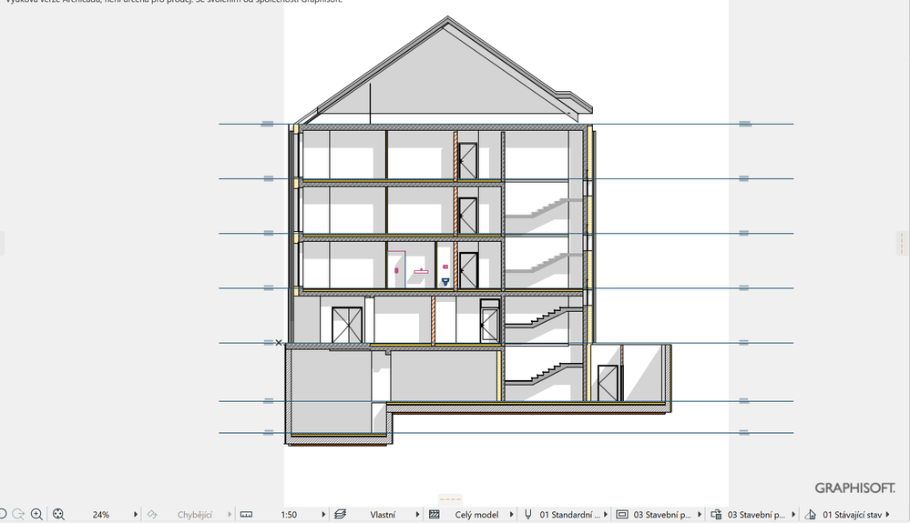

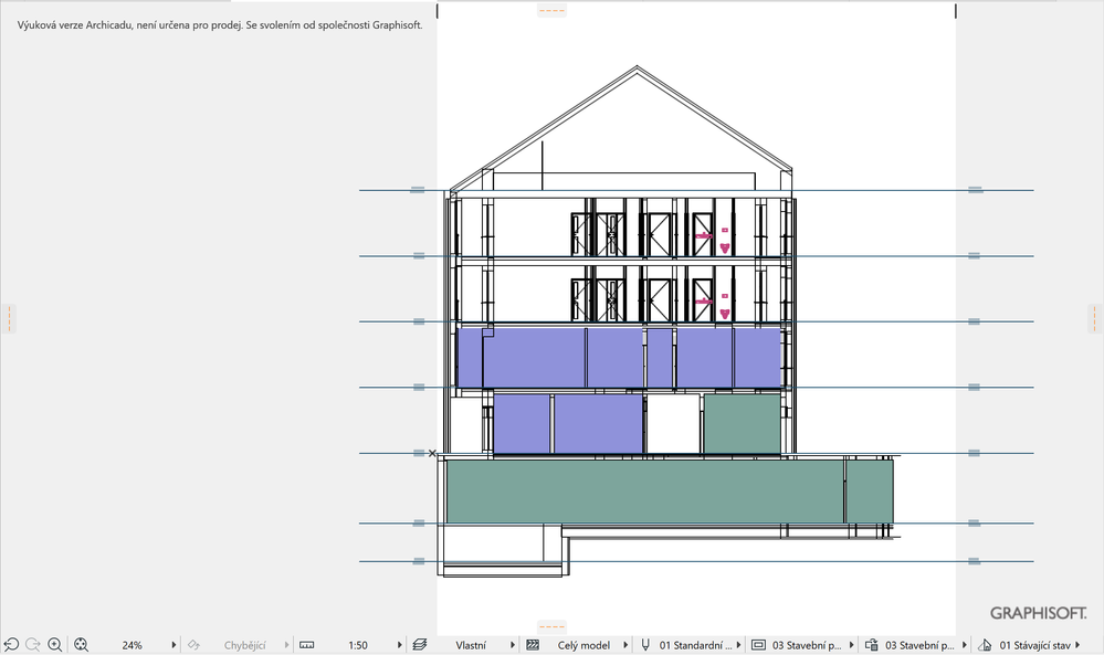

Hello,
I don't know why the section drawing changed to only elements without fills, example in pic_1, but I need it to be drawn like in pic_2. After checking the settings, I didn't find any difference or error, moreover, the drawing in the floor plan works correctly, so I don't know where the error occurred.
How can I solve this problem?
Thank you

Hi red2, welcome to the Forum.
If the settings are indeed the same for both sections then my best guess would be that you accidentally set the layers to wireframe in the first example.
There could also be some Graphic Overrides in play.
Go to post
2 Replies 2
CosminF
Hi!
It seems like you have enabled different layers and graphic overrides (altough it seems you are having the same settings)  in the sections.
Firstly, I would open the 2nd section and then switch to the first one (in the Project map) - so you keep the same layer and graphic override. Does anything change?
Secondly, You can check that both sections have the same model appearance settings (right click on each, and go to section settings) :
The parameters that interest you are Cut Fills, Uncut fills and eventual overrides.
