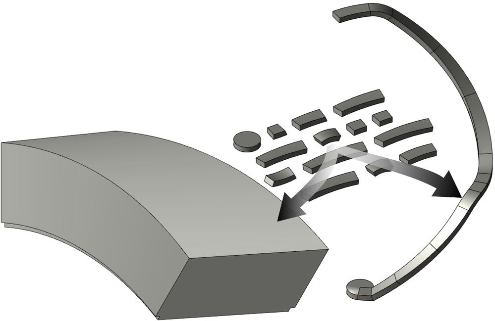

Take a look at http://www.encina.co.uk/objective.html">OBJECTiVE[url] - it could help you in many ways for this kind of modelling. You have tools to not only create profiled objects, but to freely rotate, cut, bend, and offset them. It also provides tools move complex assemblies into different working planes, so you could lie part of your pipe assembly flat to model the junctions between segments and then restore the entire assembly to its original position.
I've attached an example image. These components were modelled entirely in ArchiCAD with OBJECTiVE to manufacturing quality (the parts were cut from the ArchiCAD model). Each part can be moved out of the assembly and freely reorientated for detailing if necessary. I can provide more instructions if fell this may be applicable to your design problem.

If you want a hollow tube, I suggest using the Circular Hollow steel object bundled with OBJECTiVE. Set the diameter to 120mm, place them as required. View them in plan or elevation and (referring to the attached image) do the following:
  • 1. Select the objects to be connected and click the the menu OBJECTiVE > Tools > Split. Trace a line where you want to cut the profiles.
    2. Select the offcut pieces and delete them.
    3. The result in 3D.
    4. The profiles can be cut any number of times from any direction (as required). This is an example of a number of pieces connected in this way for rain water collection.
If a plan or elevation view still doesn't provide a suitable orientation for cutting the objects, you can use OBJECTiVE's Assembly tools to reorientate the objects, complete the detailing, and have send them back to their original orientation (there's more detail on this in the reference manual).
