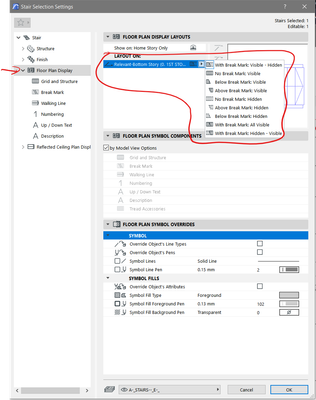

I'm having problem making stairs in AC 25, just can't create stairs the way I want, can anyone help.

go to your stair settings then can modify the following.

My problem is not floor plan display of stairs but physical design.
