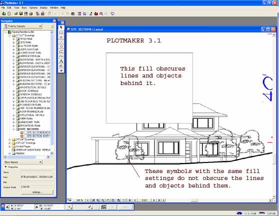

We have CC&Rs that are asking to see the relationship of the trees to the structures. We are deliberatly trying to obscure the building with the trees in this view.
Yes, the tree symbols do have fill properties. I am writing to find out why the fills are not working in PlotMaker.
As you sugestted I am posting an image of the trees and house in ArchiCAD.

Thank you Link. Your suggestion to try a new Plotmaker Layout Book with the default settings (New and Reset) put me on the path to the solution.
In the new Layout Book the fills obscured the building in the background just fine. The problem was not in the Display Options but in the Preferences/Miscellaneous setting for Fill Background Color. My problem Layout Book was using this setting at "All Fills Transparent". This setting needs to be set to "Use Fills' Background Color" to obscure the objects in the background. Of course the fills need to be set properly in ArchiCAD for this to work. The Plant Symbols in the 8.1 library do have their fills set properly as they come out of the box.
