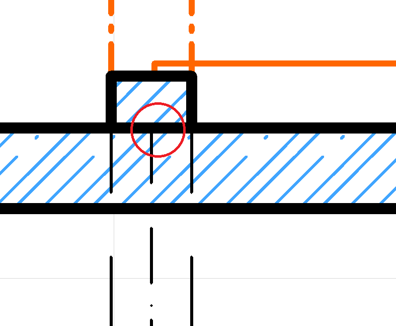

Hy,
go to element attributes->composites and selct your sandwich wall.
After the skin list button there is a check box for the separator line and then the line pen to be used.

where is the check box? here is the setting window sandwich construction.

the check box is already selected, it's on the left of the pen number 1.
I don't know which pen set you are using but try changing the number 1 to the number you have used in the wall settings.

Ok, thanks, that works. Similar problem with pen thickness - two equal wall sandwiches crossing. Help please one more.

this is not a pen problem but an intersection problem.
The inner stratus is weaker than the outer pannel.
Go to building material and change the intersection priority of one of the two materials to make it work properly. (Perhaps it's best to duplicate the inner material and youse this clone to give it a greater priority).
