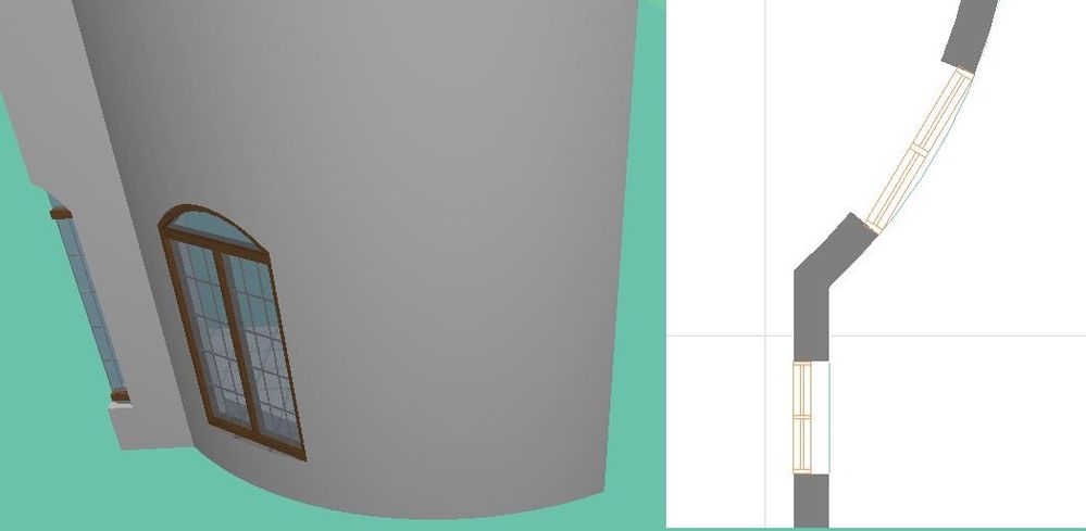

Hi i made window not available in library of archicad and then i give it symbol after saving it as a window i opened it in the object editor and changed 2d symbol to be clean but i have problem when i make it on curved wall it does not take curve shape why i need to make it curved with curved wall because it can be submitted like that here is image of my problem (noticing this window is custom made semi arch not rectangular window)

The window will not deform to take on the curve of the wall if that is what you mean. For this you will have to build a custom curved window. You could do this by building it upright (rather than the usual flat method) with profiled walls and columns (or just slabs if simple is OK). The arch top will be a bit tricky though.
