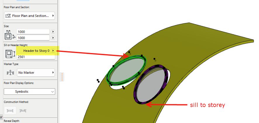

As David mentioned, you need to adjust the wall opening reference line to match the curve of your wall.
It still won't really work, because your window is associated at the sill or the head.

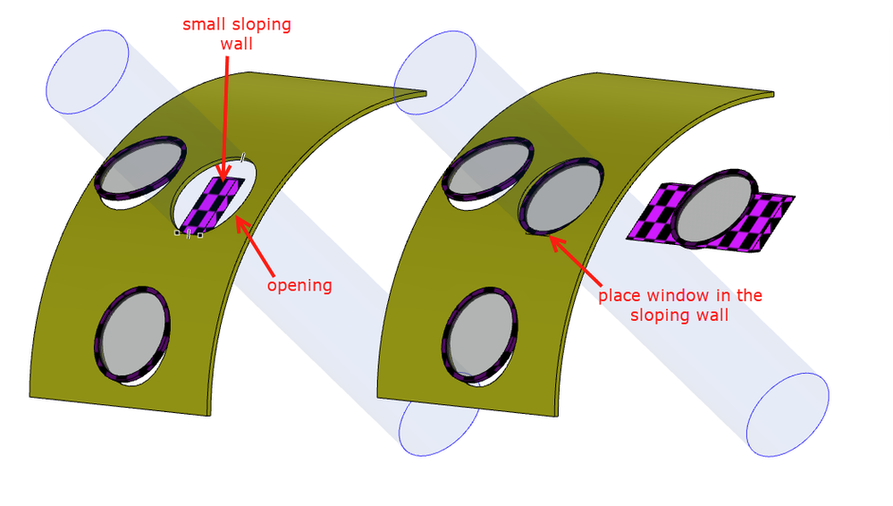

You could resort to the old trick of placing an opening in the wall.
Place a small wall in the opening and incline it to match the slope of the opening.
Then place the window in the small wall, the window will hide the wall if it is larger than the wall.
Because you have a round window, make the wall as narrow as you can.

Hi Barry, Thanks for elaborating on David’s point about adjusting the wall opening reference line. I see now why it may still be tricky due to sill or head association. Your “small wall in the opening” workaround is clever especially for a round window and I’ll give that method a try to see how cleanly it works in my model. Thank you!
