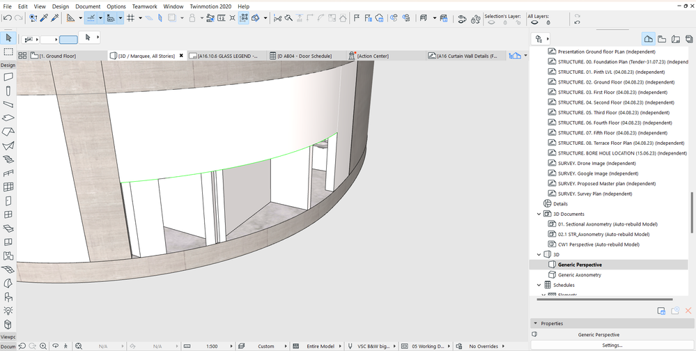

Hello Community, I am facing an error in the Info box Palette: The icons for options are missing for selection types like polygonal, rectangular or rotated rectangle this is happening specifically when simple selection is to be done and not in the marquee as the marquee shows the options properly. Just when in the arrow command u want to select, icons and those options become blank... Please help me with the same
A screenshot from the project is attached...

Nothing worked but then right now to change the geometry methods for selection and for my convenience, I have set a shortcut which is working fine! I guess there is some unfortunate glitch which my Archicad has faced. Nevertheless, thanks to all community members for the support and help!

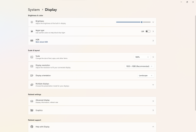

They are different icons, and different options compared to the Marquee Tool... You wouldn't happen to have screen scaling on?
Deep
Can you explain what exactly that is and how to do that?
Archicad 24
Lingwisyer
Guru
If you are on Windows:
Deep
Still the same issue persist not resolved Even closed restarted all again to apply scale to all Still same
