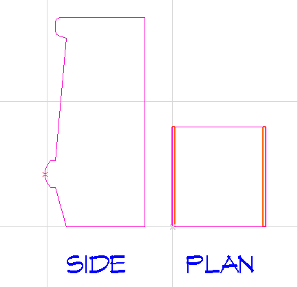

this may seem very easy for most of you so here i am asking for your expert solution.
i want to create the side profile as shown in 'side' on the plan.
So, I created the side profile and use slab to create the thickness but it is the thickness should be in the y axis but not in the z axis. how do i rotate it and the plan will have that profile?
help!
help!
Try Using the profiler tool. In version 7 it is located in the Goodies Folder. There is documentation there as to how to use the tool as well.
