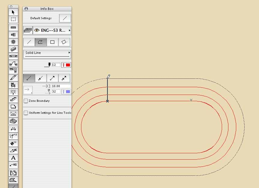

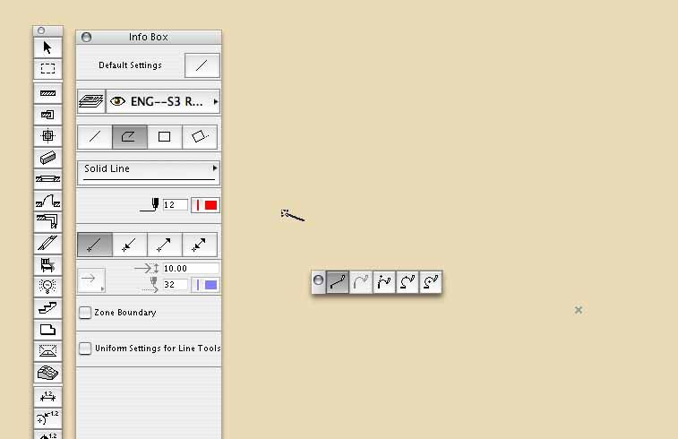

What I am on about is using offset linework to establish the edges of the stepped slabs.
Using the polyline tool with the automatic line/arc pet palette, this is the quickest way to define a shape with radiused edges.

Here is a almost finished shape
Then magic wand and offset the shape to estalish the edges of the outer slabs.
