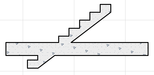

i have a structural concrete slab that intercects a same material stair.
i do not have clean intersections as you can see from the attached image. with previus versions of archicad i was able to do it right.
what am i missing?
i apreciate any help.[/img]

Have you tried SEO (Solid Element Operation)? If the stair is an Object, Objects don't use Building Materials.

David thanks!
i used the stair tool to make a stair. is this considered an object?
the same applies to morphs? i tried to make the stair a morph and i had the same results.
if i understand correctly the building materials only aplies to walls, slabs columns .. and not objects and morphs or library parts?
can you please help with the seo? should i add a stair to the slab?
Yes.
Information about element intersections can be found in the Help files at: Elements of the Virtual Building > Construction Elements > Element Intersections > Basic Intersection Principles.
Select the Slabs, set as Operator. Select the stair, set as Target. Set the Operation to Subtraction. Click the Execute button. (The Operators and Targets could be reversed in this case.)
