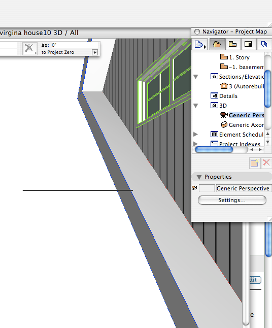

I was working in perspective view and I am not sure what I did but it seems like I broke it. haha
anyway i can either see a small upper portion of the house which is tipped on its side 90 degrees and if I try orbit or 3dfly it just goes white and the movements do not work.

here is screenshot, The house is on its side and any movement make it disappear

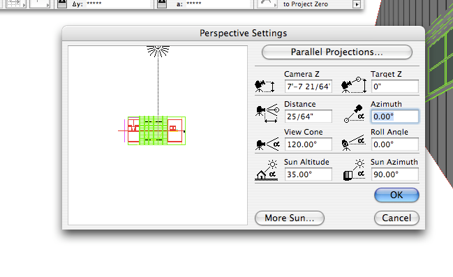

The first thing to try is resetting your 3D viewpoint in the settings dialog. This is found in the view menu or with command(Apple) + option + F3 in the default work environment.
this box? how do I reset the viewpoint?
-thanks
David Maudlin
Rockstar
eastcoast413:
On the Mac (there are similar commands in Windows):
Hold down the shift key and click in the plan view of the Perspective Settings window to set the camera placement. Hold down the option key and click in the plan view of the Perspective Settings window to set the target placement. Then check the Camera Z height and Target Z height to make sure you are looking at the model, not into the heavens or down at your feet. The Z heights are measured from the Project zero, not the current story height. The settings in the Perspective Settings dialog box you posted show that the Distance from Camera to Target is 25/64", while the Camera is at 7'-7" and the Target is at 0, this is looking at your feet (if you are about 8' tall ).
HTH
David
David Maudlin / Architect
www.davidmaudlin.com
Digital Architecture
