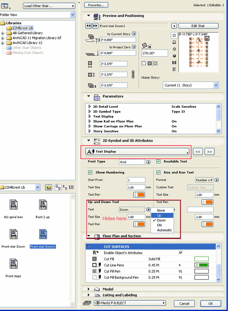

Llian
thanks peter. how do you reverse the direction?

If you mean the up_down arrow/text it's here.

Llian
this is my findings....i create a new stair but i noticed the tab Stair 2D Symbol, Arrowhead, Batten, Flight and Railing Types Pane doesn't show up. i can't change the handrail. secondly, i don't seem to know where/how to get the stairs to go down and not up. i tried rotate and mirrow ....
