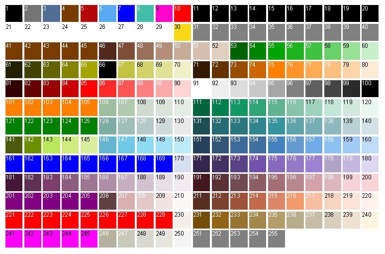

can anyone tell me how I can match the colors i see using ArchiCAD 9 to my plotter. I have a HP DesignJet 250C and the colors when plotted do not match those on my screen. Alternatively, is it possible to somehow plot the range of standard colors available in ArchiCad as an A4 (or other size) color sheet.
You can use my "Pen Table ZB.gsm" to plot your pen tables.
Good luck!
Just a ScreenShot of "Pen Table ZB.gsm":
__archiben
