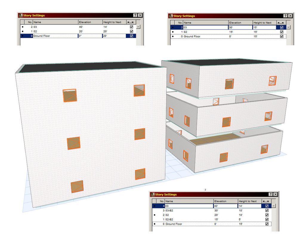

I will post again the ongoing issue with Stories.
Stories work good (not great) on the single file projects. Large projects with multiple files? Not so great. Quite often you have the different setup of stories between the architectural and structural model (main stories are the same, but you have misc stories for reference). Or when you want to delete the story you loose all associated elements. You should be given the option to move the elements to different story.
In the perfect world stories are just reference grids that you can but don't have to use.
Important constrain would be the origin (0,0,0 or the geodetic point).
I have added a mockup of how I see it in next reply.

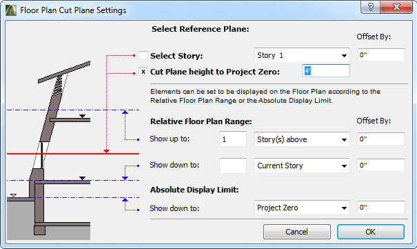

Here is the mockup
