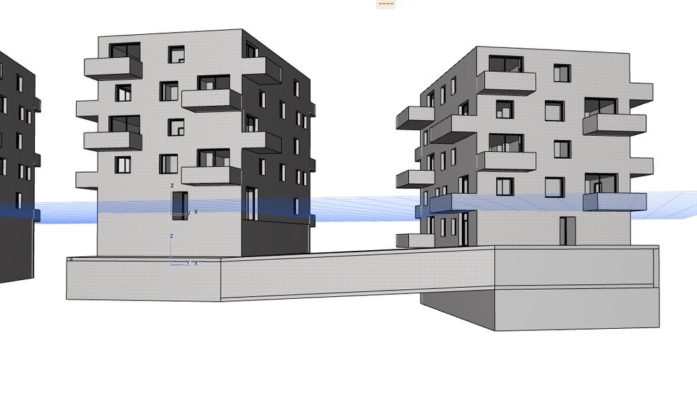

I have seen many tutorials and many discussions about split levels in archicad, but i have a very specific situation that i could not find solution for.
I have 3 buildings placed on a sloped terrain. The buildings are made in separate file, but garage and basement levels are made in this file, shown in the picture attached. So, 1. basement plan of one building is connected with 2. basement plan of second building. On the slope there is a parking. So my question is, how these floor plans can be visible together? Where do i set section plane, or what are my visibility settings because walls and floor does not display properly?
Please let me know if i could make my question more clear, i would be very appreciated by your replies!
under document > floor plan cut plane is where you change the height of the cut plane.
I would make 3 views for each building showing the right cut plane related to that building, then place 3 view on a layout.
Hope this helps.

Maybe this can be usefull
You can download my Model (AC18 .pla) from Dropbox:
https://www.dropbox.com/s/vk51pzmw6wacotc/Multi%20Building%20with%20staggered%20floors_AC18.pla?dl=0
Thank you for your help, i will give it a try and hope it works!
Nice example Andro.
