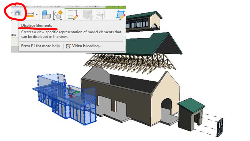

Some of you (Revit users:p ) know there's a "displace elements" function in Revit. You can take your whole model apart, but it's view-specific (so the actual model doesn't change).
Can Archicad do anything similar? If yes - then how?

No. However you could fake it with a bit of work. Make 3D docs from your axonometric viewport and arrange them on a layout.
Or follow this tutorial here (in german, but with nice pics).
