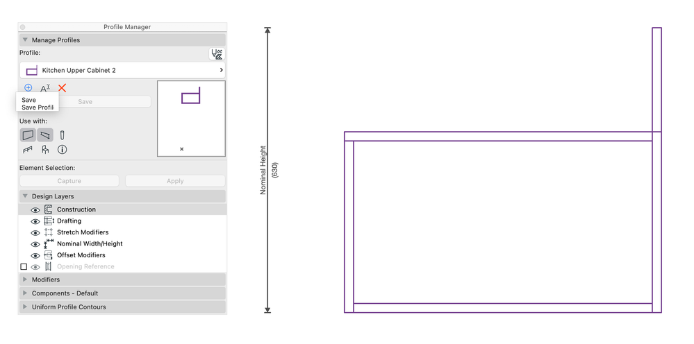

Yes the complex profiles are quite handy - if you need some inspiration, here are some screenshots from our Template...
ST-CP-Joinery-KitchenFullCabinet.pngST-CP-JoineryKitchenBenchCabinet.pngST-CP-JoineryKitcheUpperCabinet2.png

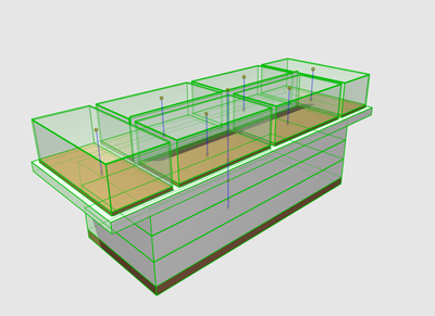

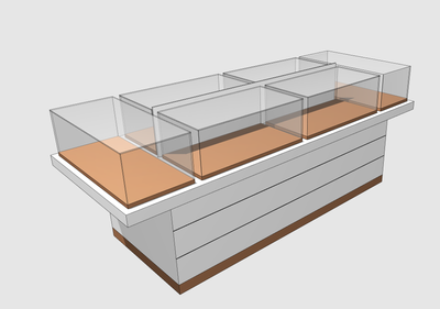

Segmented Beams and Columns are also good options.
Also based on the amount of detail you need you can start creating one file per furniture object and insert them as modules.
One column display cases examples:
