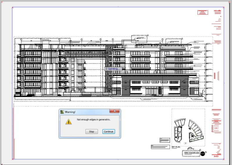

"Not enough edges in Generatrix"?
rob2218
what does this mean?

it means you haven't been reading Asterix!
seriously it usually is an error with the 3d display of an object that has become corrupted.
rob2218
Geeez...more corrupt data?
sheesh...how can I find/fix/corrupt/"destroy" that darn object that causes that error?
what's the process for find the bad culprit?
Binary search: model half of the building, if the error occurs model half of that, otherwise take half of the other. Since you are narrowing down by powers of 2 it zeros in very fast.

rob2218
....well, I tried the Lohan Method of finding the offending object.
when I model 1/2 the building, the error doesn't show, when I model the other half and "show 3d in selected marquee"..the error does show but....then I model the two halves where the error "SHOULD" occur and the error NOW does not show up anymore??...so I'm perplexed.

You can use the same principle with layers - half on, half off, keep reducing till you find the culprit.
