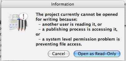

We've got the same problem here and it's escalated during the last 3-4 weeks.
The latest hotfix (build 2219) was supposed to fix the problem but had no effect.
This is really annoying and I suspect this causes additional faults.
- TW-files not accessible due to Server claiming the files are in use.
- Unable to erase files from server due to Server claiming the files are in use.
- PLN files not accessible (se enclosed img)
- LBK files can't be saved (258:access to file or file data is denied)
I would really like Graphisoft to dig in to this problem cause this is costing us lots of time, money and trust in the software.
Server is running 10.4.6, network is GB, users are on 10.4.5., all are local hardware key's.
This is not a problem in ArchiCad 8.1.
