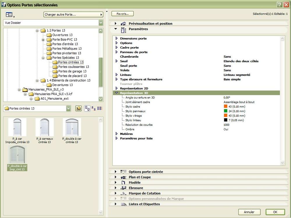

Hi Peter,
Sorry for the missing information. I'm working with Archicad 13 (french version) using the basic objets library 13.
Yes, these lines are the opening lines of the window. I didn't have this trouble with Archicad 10, the previous version I was using.
Following your instructions, it appears that I do not have such an option into the 3d objets settings (see attached file).
I have already tried to change all parameters of the objet itself but the red lines are "resisting"...
I have tried also other kinds of window objets. Same problem in 3d view.
Regarding your last question, the 3d is gray by purpose (gray paint & texture) at this stage of the project.
Thank you Peter.
Thank you Peter.

Hi again Jean,
In AC13 these settings have been moved to the Model View Options and now apply to all doors and windows at once. See the attached image.
Hope that helps.
Hope that helps.
