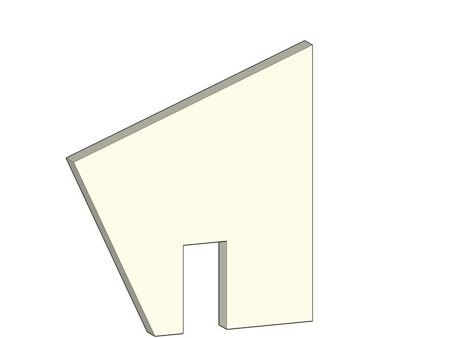

How can I do a wall like this? I asked prevously but never got a solution. Its imperative I figure this out soon or im going to have to go to another program.

Simple:
form a roof and either trim the base of the wall to the roof or use the other useful command of solid element operations to subtract the roof shape from the wall

I assume you are working in 10. As mentioned solid element operations is a method. If this wall is joining a splayed wall, the splayed side of this wall will automatically adjust to the shape indicated and you only need to deal with trimming the wall to the roof.
how can you remove the splayed wall and still retain the angle on the remaining wall?
nevermind i figured that out. i knew this wasnt anything hard. however, is there a way to group the walls together so that they will all move together even when the operand walls are hidden? That way if i need to move the wall i dont have to go through the trouble of making the operands visible and selecting all of them, not to mention its much harder to accurately move the wall if they are all visible.
Edit menu/grouping (command/control G). Be aware that there is also a feature called suspend groups. You need to make sure this is not activated when moving a group that you want to keep the same relative positions.
