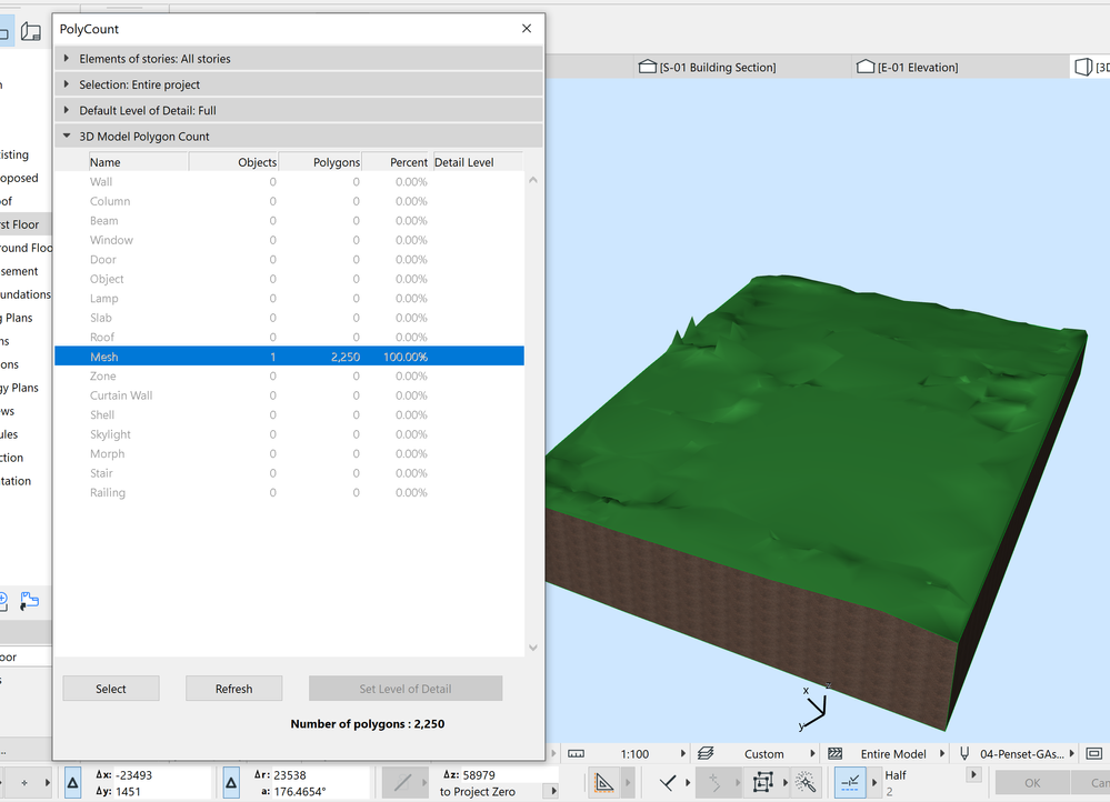

sorry it took so long to get back to you about this. I was traveling and didn't take my computer with me.   It looks fine to me.  2021-09-27_15-48-23.png
If there are some anomalies you can edit the nodes graphically in 3D to a more appropriate location or height.    https://www.youtube.com/watch?v=pbQ-gZc0PMc   ??
