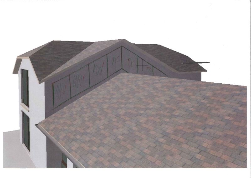

hi , pls give me advice how to create that window. I thing using roofs and glasing wall,but i don't know how to do it step-by step. thanks for any advice.

Here is a link to a tutorial I wrote:
HERE
Good as your tutorial was at the time, David, it is very much out-of-date.
Absolutely NO GDL script editing is required. The wall-cutting slab simply needs to be given the ID of "wallhole". See the annotated version of your article on the wiki here:
http://www.archicadwiki.com/TechNotes/Creating_custom_windows?highlight=%28window%29%7C%28custom%29
(Since this improved method is already several years old, we should probably delete the script-editing portions of the wiki article so that the steps are short and sweet. Maybe you can do that on your site?)
Starterr, The method given is the easiest/best way to create your window. In your case, create a fill in a section/elevation to define the shape/size. Copy the fill to plan and magic wand it into the various slabs required (glass and wallhole) and magic wand the frame onto it. Etc. Then save as indicated in David's tutorial.
Cheers,
Karl

thank you. i have one question: do you know how i can change gdl script of windows / i mean top and bottom of window could be angled that i can put the same or different angle like roof, and left or right part could be vertical but with possibility to put angle as well/. it will be great. thanks.

I assume you mean the standard windows?
Look for W Trapezoid Fix, etc in Special Windows folder. You can set the height of each side to get an angled top. (Would be nice to specify the angle, but they didn't program it that way.)
To modify an existing window would be a huge task.
