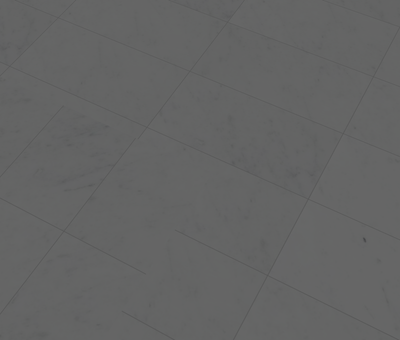

There is a texture issue when finishing a stair with a Tread though as you cannot edit the UV of the stair...
That is with the stair SEOing the slab. You can minimise the affected area to just the nosing by editting the depth of the top tread, then doing a SEO with downward extrusion on your slab.
