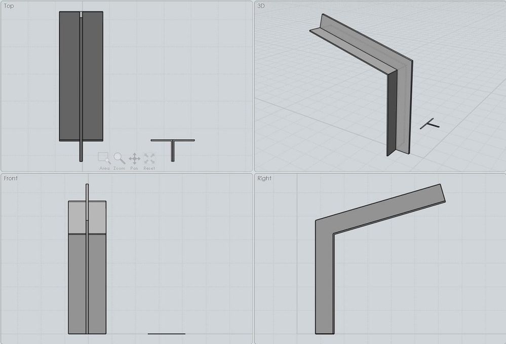

how can this be modeled in archicad ?
I modeled this in MOI3d in 35 sec. and i cant do this in archicad.
I can model this in MOI3d and export it as 3ds and import in archicad but can you do it in lets say objective, archicforma,or archicad tools ???
This is 2 L profiles 80x80 mm . . .
thx
p.s. I think that i will finish this in MOI3d cos its to fast and i think its a pain i.a.
to model this in archicad.

Is this what you were looking for? I made this in 10 second inside ArchiCAD.

If I had only 35 sec and do not need any parametric stuff, I would use wall profile in plan and save as object (rotate). In AC 13, you don't even have to create the profile. 15 sec.

ok 10 seconds, you beat me
this is what im looking for . . .
Its a start and a quick one
I cant finish this in truss maker cos i cant get exact model
so i need to model this old truss and it will be demolished anyway
i didnt try with profiler . . .
truss web is differnt sizes

how ? 10 sec
try...
If you do not need sophisticate joinery, you can work in plan with walls and rotate. It is an existing structure to be demolished, so it does not bother if it ends as objects, right?

how ? 10 sec
profiles
Gorazd
It was made with Trussmaker. I know it is simple one, and I dont know if i could do with it the entire structure from your photo. But I didn't know the complexity then.
