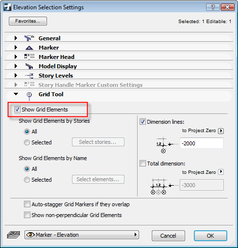

I have placed a structural grid on my drawing using the structural grid tool, is there anyway to show the structural gridlines in the elevation views? or do i need to draw them myself?

this is available in the grid element settings window, although i think some of the options are turned off in the work environment settings, as we were missing most options initially.
see screenshot to give you an idea of what is available; note; section/elevation settings options.
In the Grid Element Settings Dialog you define how the Grid Element should look in Section/Elevations, but it is the Grid Tool panel of each Section/Elevation Settings Dialog where you have to enable Grid Elements to be shown in that Section/Elevation.
