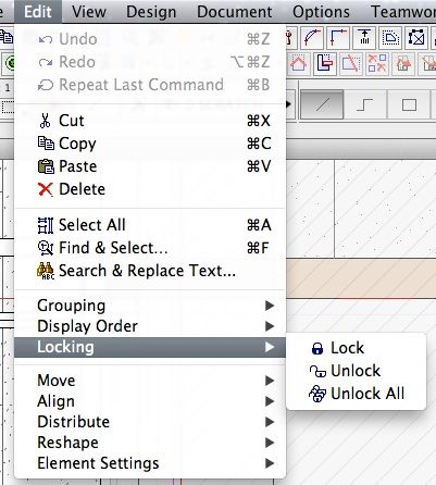

Hi Lennox,
There are two ways:
1. Under the EDIT pulldown menu as shown. Not very quick but it's there!
2. Add it to one of your palettes - I've got mine in the ARRANGE ELEMENTS palette. It seems to be a logical place for it.
Cheers
