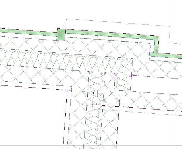

the continuing saga of composite wall clean-up disasters...
i hope the screenshot is self-explanatory.
the issue began with the two rebates being formed vertically at the interior wall junctions as shown. however: it is the outside skins that are to blame!
further messing around (several hours. can i send you my invoice graphisoft?) revealed that the walls were not joining in junction arrangements that I had set them to.
the wall reference line should form a continuous line around the exterior of the building because i had carried out an 'intersect' command on them. they should NOT suddenly shoot off into the building along an interior wall if i 'adjust' the internal wall up to it.
in the example below, skin priorities are as follows...
14 - external core
12 - internal core
6 - interior lining
4 - exterior cladding
... which leads back to the original 3D problem: how the hell does an exterior wall skin - with a lower priority than the internal linings - form a rebate in that lining on the other side of the wall?!
(and yes: priorities have been checked, double checked and examined in the finest detail. all walls are set to use the settings of the composite.)
remember this is nothing fancy: it's pretty depressing that after twenty-four(?) years the basic building blocks of archicad - walls - cannot form a simple, everyday junction correctly. don't even get me started on wall/slab/roof junctions...
THIS HAS GOT TO BE ADDRESSED SOON.

Aussie John
Best I can do Ben is boost the connecting wall ( with window) skin properties to very high and reducing the plaster of the composite wall to very low. Leaves a line in 2d but gets rid of the rebates. In my view is definitely a bug if the 3d looks different to the 2d.

__archiben
thanks john. the whole wall/composite wall junction display is long overdue for an overhaul. sure, it got patched up a bit so that complex profiles could be included without having the villagers torch the castle, but it's still missing so much and should be amongst the top priority features to fix.

__archiben
well. i've fixed it up: but only by changing my working methods: it seems that if the reference line is offset from the wall edge - like to the edge of the core or something sensible like that - then the priorities of the skins jump all the way through the wall . . . not just as far as the reference line.
ugly. bug.

Firstly I think its fair to say that composite priorities work most of the time, however they are complicated to use, and not reversible with an undo command, so you can easily spend half an hour sorting out some complex junction. I would like to see some way of setting individual skin priorities either in plan view or within the wall toolbox.
Secondly there are still junctions that skin priorities can never deal with, nor composite walls. Enclosed is a screenshot of one I drew a couple of days ago and had to patch.
My view is that there needs to be the ability of creating a polygon wall with its own patch symbol embedded in it, which can be edited as necessary. As to how this might work I don't know.
