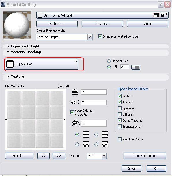

The Vectorial Hatch pattern in 3D is based upon the Assign Fill pattern to that material. You can change the Assigned Fill Pattern of a Material or better to copy a material that is similar to what you want and save under a new name. (This new material should then also be part of your template File so that it will be included in all future projects that you start with your template.
In the new Material, re-assign the Vectorial Hatch to a fill that you like. Again if there is not a Fill pattern that you like find one that is close, create new fill from that fill and adjust the Angle and even the x & y spacing dimensions.
The Fill type Dialog box
