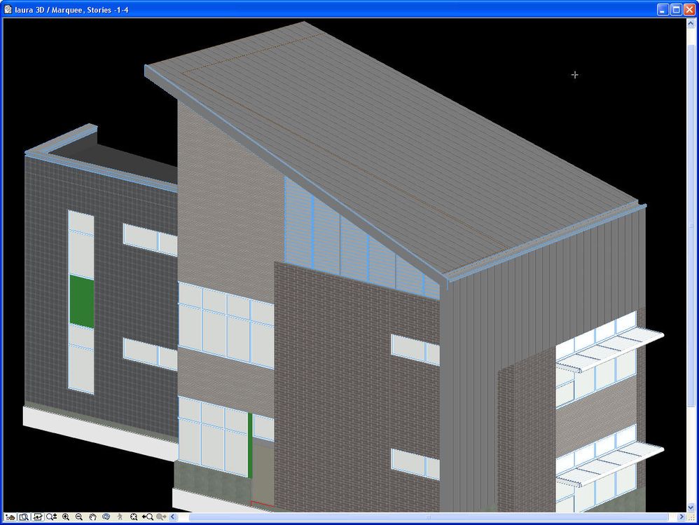

If AC simply allowed for sloped walls with consistant height, it's be simple......
That would be the Beam tool, if you want to avoid cutting a wall with Trim to roof or SEOs like described above. You can also make a custom profile for the "beam" if you want. I've no idea of how it interacts with Cadimage, though.
But I think you've got the answers you need to model what you want by now.
Yeah, the beam tool woudl physically do what I want, but still would be good for AC to allow walls the same functionality.

Laura Yanoviak
Yep -- the Beam Tool (via Custom Profiles if necessary) is your answer. The parapet coping, eave fascia, and gutter of the attached screen shot are all Beams created with Custom Profiles.
