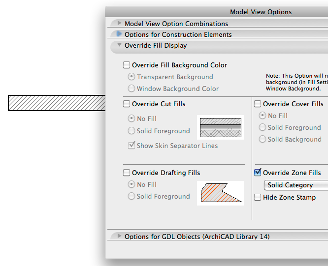

hey everybody. i got a little question here. I try here to make a plan drawing with wall construction showing in the plan in archicad. I dont know what i am doing wrong, but i have tried a lot ,and i just get a empty wall drawing in my plans. i hope i was clear here the thing is , i will show construction in my plan in archicad.

You either do not have the desired cut fill associated with the walls (e.g., the diagonal brick shown in your example) - or your Model View Options are set to hid the fill. Or your wall is below the cut plane. Or...
Attached is a simple wall with cut fill brick and note that for in the Model View Options, the cut fills are NOT over-ridden... Play with the Model view options to see the variety of drawings that you can get from a single model...
Hope that helps,
Karl
