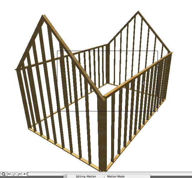

Does any one knows if the wall framing add-on on the extras menu works on gable walls ?

sort of . . . attached image was just a quickie. the only change i made from the default settings was to turn on the option to 'use wall top edge'.
it really didn't like the junction between the gable/eave/side wall did it?

It would probably work better if the gable (upper) wall were a separate element.

yeah? junction looks butchered and it completely stuffed up the other end!
(admittedly i haven't been taking too much care and attention whilst generating these - just seeing if it was possible . . .)

Since I'm new to the wood framing system do you believe this add on will give me all the design elements necesary on a wood framing system
Has anyone used this tool that comes in the AC9 package on a real project?
or should I get this other tool that sells for 499 Dlls.
http://www.cadimagetools.com/home.php?page=products&productID=185
I'm sure it won't do everything you want, but it may get you close enough. You'll have to try it out to see how it fits your particular needs.
