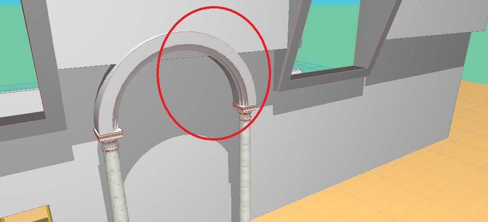

what is the best way to model this arch that has profile?
i modeled this arch using shell tool as i think primarly during early stage design but i want to draw it using profile manager to be more accurate and as it has certain profile is it possible to make this arch using profile manager ? if it is how and thanks
3 REPLIES 3
For this type I use Objective
If you don't have access to Objective you can model it flat with profiled a wall and then save that as a library part.
Why do you think you can't be accurate enough using shell tool?
