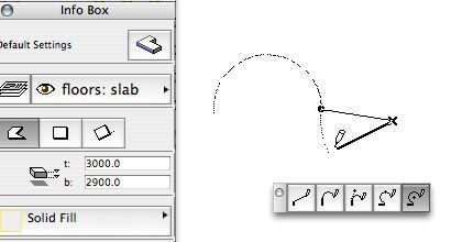

or simply use the pet-palette options for different geometric construction methods. start drawing your slab and choose the pet-palette icon that suits best how you want to draw the next segment of the polygonal shape. see the attached screenshot . . .
HTH
