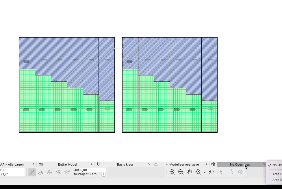

Graphic Override dynamically changes the colour of the zone according to its size.
>> Displays flats of the same order size and in the same colour

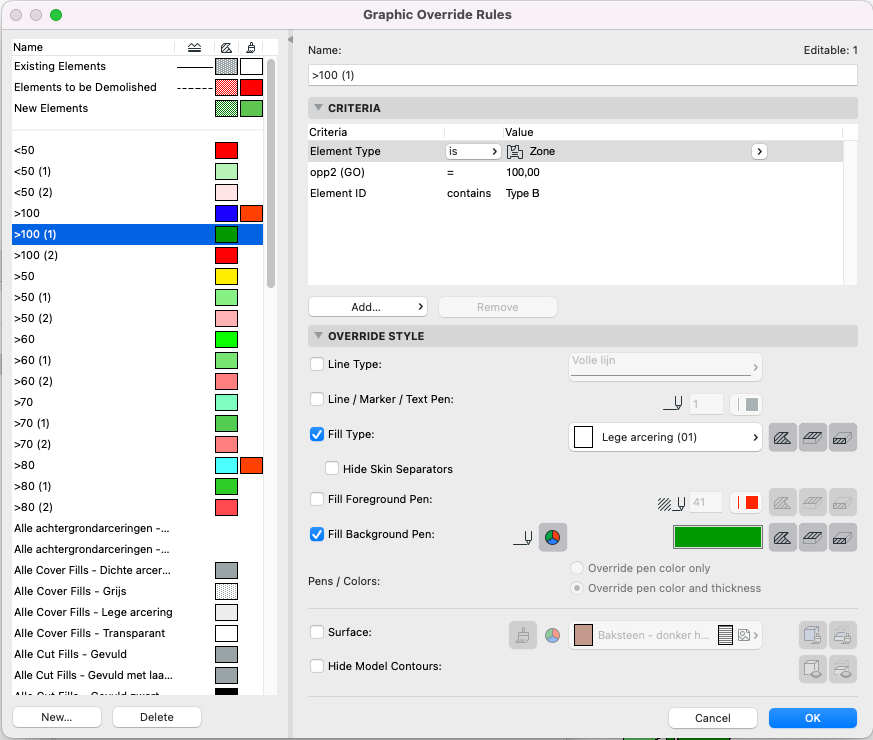

This is controlled by a parameter (opp2):
Graphic overrides:
Graphic overrides rule:
