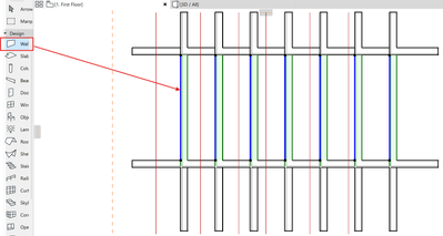

I feel like someone is going to erase a whole lot of overlapping / neighbouring elements that they did not intend to without realising if it was made generic... You would definetly need some quick filter options.
Martin Jules
Mentor
There's no need to filter elements. Just activate the tool(s) associated with the elements you want to erase:
It's like in AutoCAD for example. This will also help speed up the workflow.

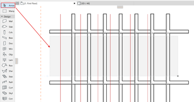

This option currently allows elements to be trimmed or deleted one at a time. I suggest making the deletion like the selection process, allowing users to delete or erase multiple elements using the same selection methods:
We can also decide to remove elements as follows:

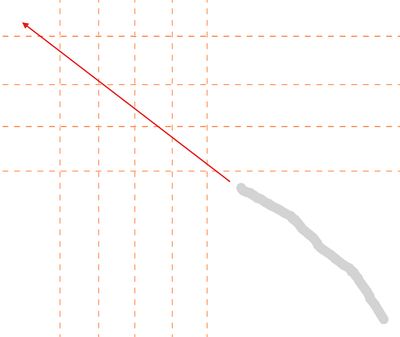

Martin Jules
Mentor
This drag-to-erase method is actually possible with the "Erase Guide Lines" option in Archicad:
The drag-to-erase functionality should also be available for other architectural elements.
