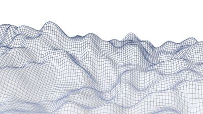

BIM optimized procedural terrain generator
Possible use cases of such an object. It could range from conceptual renderings, schemes, axonometric projections, facades or sections. It can quickly generate believable terrain when you do not need any specific location.
Main settings are number of iterations (or octaves)
And colors for "heightmap" effect
Resulting effect of heightmap
The genarator is pseudo random or full random
And multiple view types are supported, including NURBS
This can also be animated
