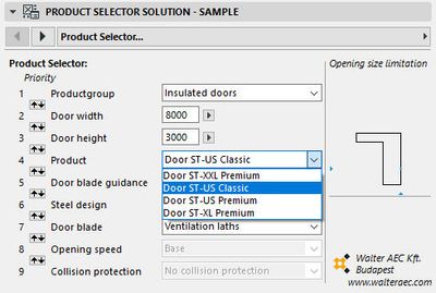

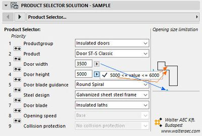

1. PRODUCT SELECTION USING HIERARCHICAL PARAMETERS

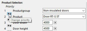

It can be very helpful for the user if they can easily find among a range of products from a manufacturer whichever product most fits their needs. In this solution the order of the hierarchical parameters determines their “importance” and can be rearranged.

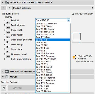

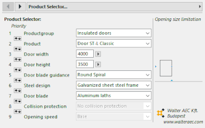

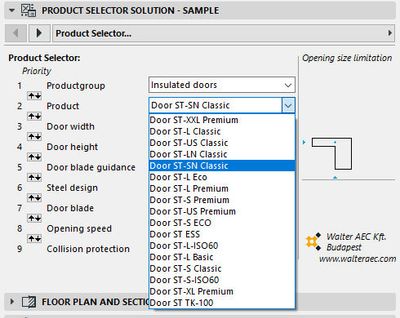

In the sample Archicad GDL object we can see features of industrial doors. If the size of the door is the most important aspect, we can move the Width and Height parameters to the top, and sort through the remaining options afterwards. If we would like to choose based on the type of product, then the Product group parameter should be the first one. Similarly, any other attribute can be prioritized as needed, e.g. Opening speed, Door blade type, Materials, Design, etc.
How does it work?
A macro type element stores all the possible parameter combinations in one or more arrays. The order of the parameters determines the way the combinations are filtered. After setting all the parametric options, the result is one specific product.

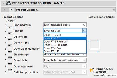

2. LIMITING OPENING SIZES USING POLYGON
The size restrictions for each door are defined by a polygon. We get the available height values for any given width (or the other way around) by points of intersections. In the sample GDL object, the polygon corresponding to the door type shows graphically on the User Interface.
