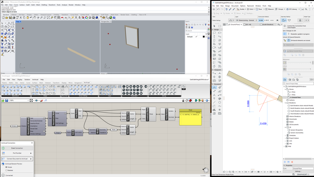

one more question, how do i get a normal vector of a window or a plane that the window lies in?
I am not very proficient in Grasshopper so there may be a faster way to achieve this. I wanted to get the plane of the Window's host Wall, and get its Normal vector. I did the following, going from left to right in the image:
  • I have a Window component that stores the geometry of one or more Archicad Windows. This example has one Window.
  • I used the Deconstruct Window component to get geometries related to the Window, and used the Wall output to get the geometry of the Window's host Wall. Notice that the Flatten option is ON for the Wall output.
  • Then I used the Decostruct Wall component, and used its Curve output (Flatten option is ON again) to get its Reference Line.
  • I used the End Points component to get the Start Point and End Point of the Reference Line.
  • Then I used two Vector 2Pt components to generate two vectors. The first one goes from the Start Point of the Reference Line to its End Point. For the  second one, first I used a Unit Z component to generate a Point vertically above (by a Unit Z distance) the Start Point of the Reference Line. Then I used the Start Point of the Reference Line and this Point above it to generate the other vector, which is basically a vertical vector. (You can see the three dark red X-es in the Perspective view of Rhino that shows where these Points are.)
  • I used to Construct Plane component and used the Start Point of the Reference Line and these two vectors to construct the vertical plane along the Reference Line of the Wall.
  • Then I used the Face Normal component with this Plane as input, and the Normals output gave me the Normal of the plane.
This will work only for straight vertical Walls, so if you are using it in curved Walls or in slanted Walls, this will not give a correct result, you will have to work more on it to solve those cases. 
